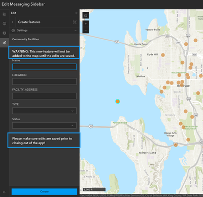

For the second request, you might be able to complete that now in your web map using the smart forms. In the smart form you can add additional messaging that appears while folks are editing in your Sidebar app.
