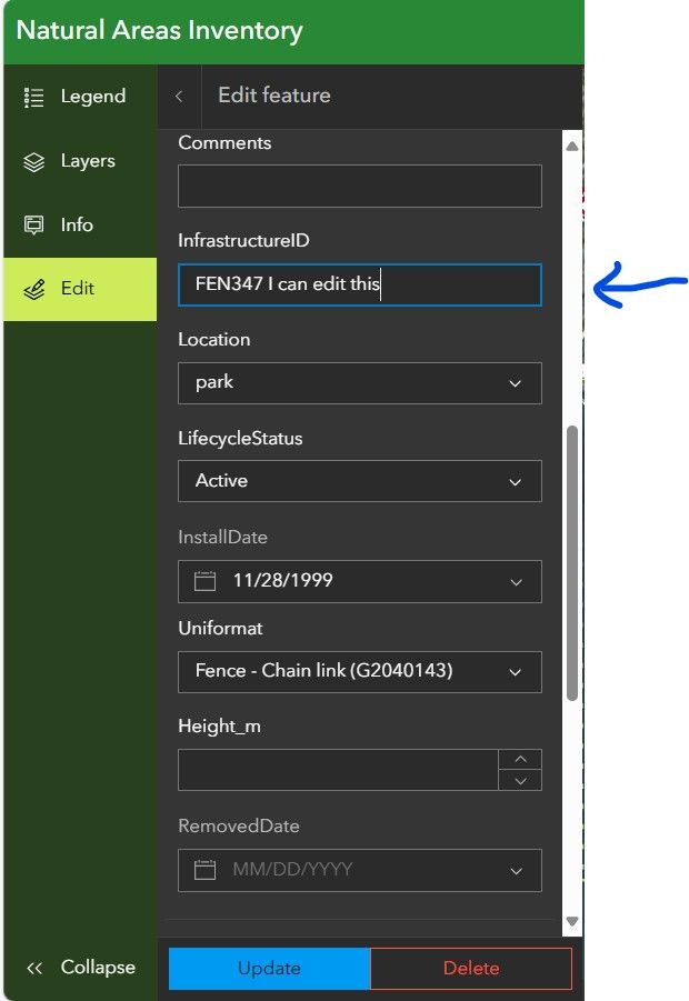

Today I learned that Instant Apps do not honour that setting.  I used a published feature layer as usual, whose InfrastructureID field was marked "Read Only" in the aprx.  However, in my Sidebar Instant App, the field was still editable.  I tested editing it and saved, and my changes saved.

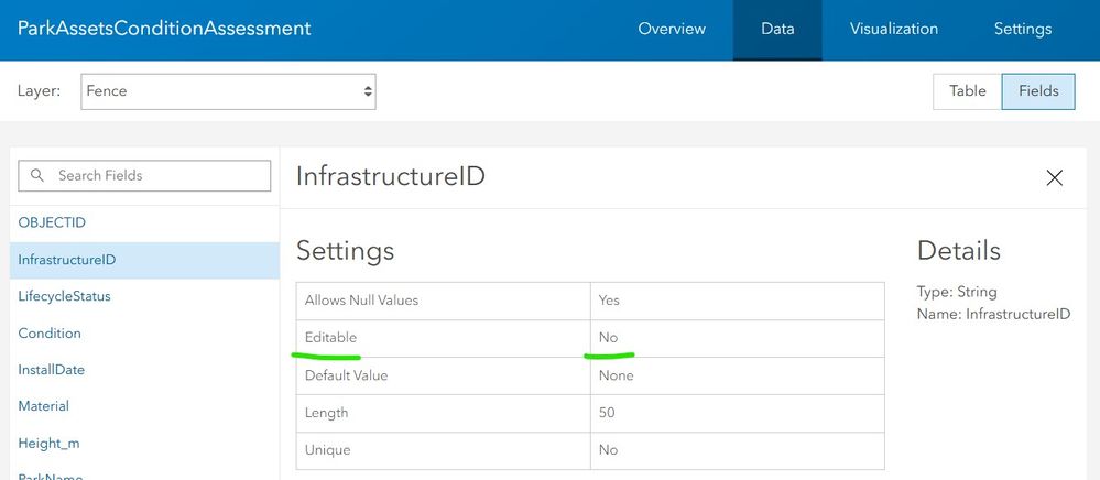

Thanks for reaching out about this. I had a chance to look into this more. Can you confirm that on the layer in Portal that the field is not editable? You can confirm this by going to the layers item details page > Data > Fields > click on the field and confirm that it is not editable.

Thanks for the reply.  Yes, I can confirm that on the layer in Portal the field is not editable:

Can you share a screenshot of your Sidebar app where the field is editable? As I mentioned above, I was not able to reproduce this behavior on my end. I tested this in ArcGIS Online and in Enterprise 11.3.

Sure thing:
I just tried setting up a new web map and a new Sidebar instant app using the same data, and that one did not allow me to edit by default.  So perhaps this was a glitch in the matrix?  I think I applied all the same configuration settings to the new test layer (e.g. popup title, field visibility).
I am hopeful this was a one-off glitch.  I'll have to go back and check some of my other Sidebar apps to see if any others have editable read-only fields.
