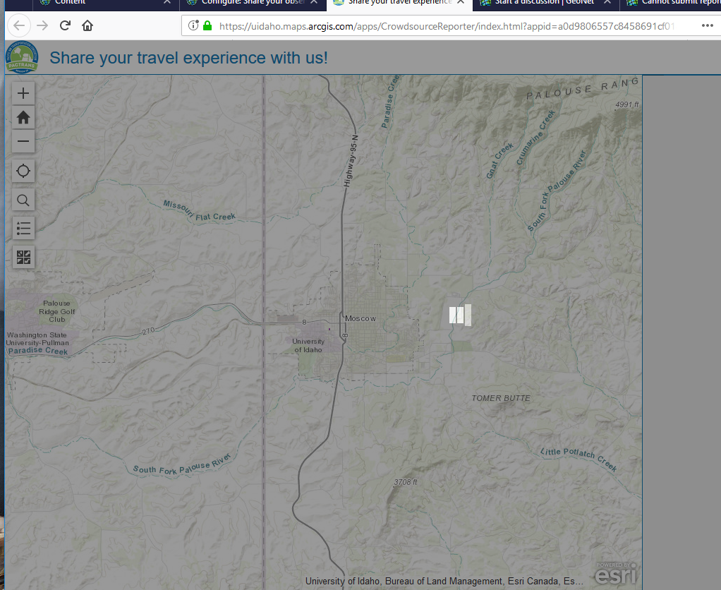

I had a correctly configured Crowdsource Reporter on my ArcGIS Online account that was working properly. I decided I wanted to delete a field in my Hosted Feature Layer and I was no longer able to submit reports. When I clicked the Submit a Report button the loading icon will spin forever. After an hour of changing the settings of my hosted feature layer, web map and Crowdsource Reporter Application, I was able to get the application working again. Unfortunately I am not sure how I fixed it, and needed to delete a second field from my hosted feature layer. Now I am running into the same issue again.
Can anyone explain what is going on or what exactly fixes this issue? It's similar to the problem described in this thread:
, except I am not receiving an error message. The program just becomes unresponsive, I let it spin like this for 30 minutes but never got an error message.
