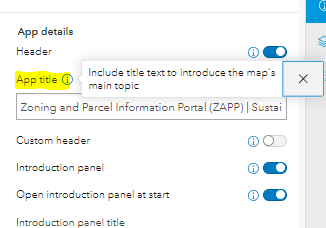

App title is being truncated in Sidebar App.
I am trying to input the App title: "Zoning and Parcel Information Portal (ZAPP) | Sustainable Development Areas and Complete Communities Areas"
However instant apps is truncating it to: Zoning and Parcel Information Portal (ZAPP) | Sustainable Development Areas and Compl..."  ete Communities Areas is cut out of the title
There is plenty of room in the header for the longer title.  I checked the info icon if there is a maximum title length, there does not appear to be one.
I thought maybe it would need to be adjusted in CSS, but the title is simply truncated, if I type a longer title in the dev tools, it displays in the header no problem.
How do I input a longer title in Instant Apps?

Sidebar currently truncates the title if its longer than 100 characters but we are looking at the logic to optimize the amount of space the title can take and it should be improved in the next release of ArcGIS Online.
In the meantime you can avoid the truncation by using the custom header option. If you set that you have more control over the length of the title. If you run into issues getting your title to look the way you want using this option post back here and I'll take a look.

Thank you @KellyHutchins for the fast response.  I was unaware of the custom header option, and a bonus more control over how the header is displayed.
