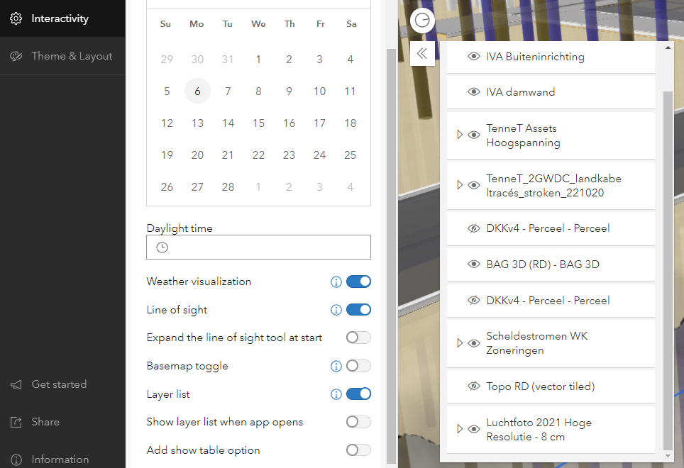

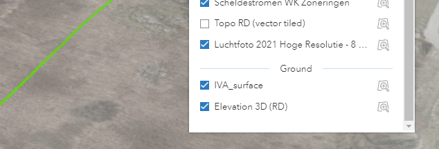

Hello,
When I add the layer list to the user interface the ground elevation layers are not visible in this list. In the webscene, I have added them to the layer list. With several ground layers, it is possible for users to see differences between as is and as built
In a story map I have added several instant apps but now I also have to add the web scene to the storymap, which may confuse users or a client.
Webscene: Ground layers selectable
3D Viewer: Ground layers not selectable

Sorry I missed this one until now. I'll take a look and see if we can add support for this in the next release of ArcGIS Online.
Stefan_Thorn
hello @KellyHutchins,
it seems to me it is still not possible or do I overlook a setting in the instant apps?
KellyHutchins
Esri Notable Contributor
@Stefan_Thorn unfortunately it is not in the app yet. The scene viewer has special logic to allow this to happen within the layer list that has not yet been exposed in a widget that we can include in the application.  There is an idea here where someone asked for this capability to be added to Experience Builder.  You can kudo it to show your support for the idea because Experience Builder and Instant Apps would both use the same widget.
