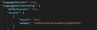

      5. Navigate through the JSON and find the “languageSwitcher”. You will see all the languages you previously selected listed as locales.  Under each locale, a webmap parameter can be added to identify which webmap should load with that language.
To do this enter in “webmap”: “add in the webmap id”
Verify there are no errors and save.

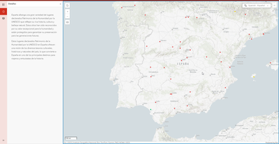

     6. View your Instant App and toggle to the language associated with the webmap. You will see the updated map load.
Test out this sample app, which updates the map’s basemap to a Spanish version.
