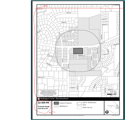

Great app. This is a very important part of the planning process and a much needed solution. I agree with others comments about adding the ability to highlight the selected parcel/road as a unique feature and having the selected parcels as another unique feature in the legend. I did these maps for several years and we always have these elements and the buffer area outline (see attached). We always wanted to give this task to non-GIS people but couldn't because there wasn't a good solutions available. This could be it!
The map is one of the most important pieces for our organization.  It would be amazing if everyone could add our own print service to the app. This lets everyone control their branding and page size. In the attached example we could easily rearrange the map and move the circled informative text to the top and slide the legend area over to keep things simple.
Other nice additions would be the ability to give the legend items custom text labels.
