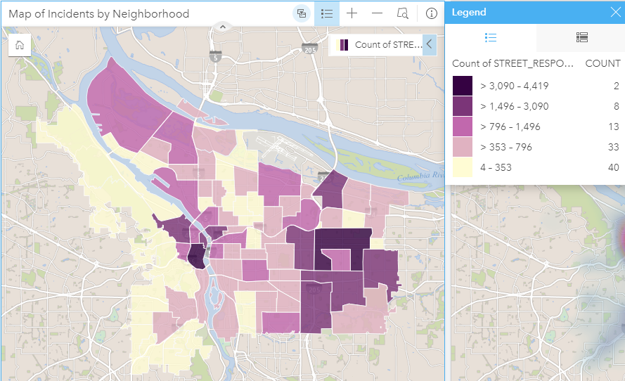

I have an Insights page which pulls in incident data from our 911 dispatch system.  The database is updated every morning, bringing in the data from the previous day.  One tile is a spatial aggregation of Incidents by Neighborhood.  I set up a schedule for a daily update, using the Schedule updates for shared pages tool, expecting that the spatial aggregation would rerun, and the numbers would increase every day, but they don't -- the spatial aggregation is static.  Can I get some clarity on what "update analysis" means with the Schedule Updates tool?  Seems like rerunning simple spatial aggregation would be a pretty basic thing.

Hi @PaulCone2 ,
Something strange is going on, aggregations should be updating. Are you sure that you are looking at the shared page, and not the workbook that the page was shared with?  Any way that you could do a screen share with me [email protected]?
