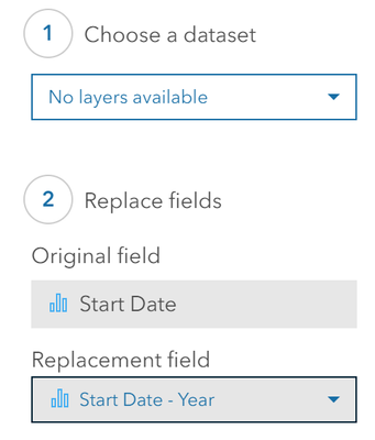

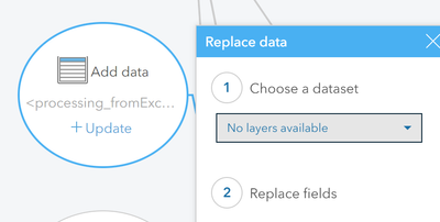

Ok, so I rebuild my model and all my cards. I saved the page, the model, and theme, and exported a package. After rebuilding, I needed to make an update to my table, so in ArcPro a shared through the 'Overwrite Table' option. Fields are all the same, just a minor change to the rows.  I reopen ArcInsights, and it is broken and when try to update the data source in my models this is what I see:
Just for clarification, I started a new page and I readded the datasets I was working with. This is with the data layer in the worksheet. I just doesn't recognize that it is the same layer. I tried replacing the fields, but it just went let me update it with the overwritten layer.

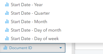

The only thing that I can thing could be the issue is that there is a 'Start Date' field in my table that was a Date/Time field in my model. Maybe it won't read it as the same table since it separates the Date/Time into multiple fields in the page once you change the field type. That's the only thing I can thing of because I didn't change anything except to remove a record.

Scott_Aulen
Yes this is something I've noticed recently as well and does speak to the larger issue of our models perhaps being a bit too restrictive which we are examining.
In this scenario, the model is looking for the Date/Time field so within Insights if you change the {Start Date} field to Date/Time you should be able to update the model.
SaraHedrick1
Scott,
I tried that. I can see where that would work in theory. Even after changing the field in the contents panel to 'Date/Time', it doesn't recognize the layer as an option. I tried making the field date/time in ArcPro, and it didn't recognize that either.
I tried a republishing and handling things a couple different ways, including uploading the excel directly instead of publishing as a table. It doesn't recognize that any layers are available, so I can't even force it through. I think I have to rebuild it yet again.
