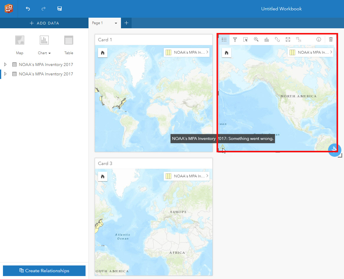

Can add most of my hosted feature layers from AGOL into Insights, but one particular layer throws the "Something went wrong" error.  This is the service that won't load.

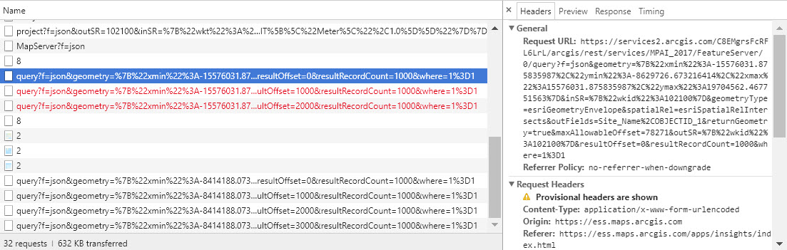

I tested this out with your feature layer and noticed that the queries made under the hood to the feature service are hit or miss. I added the feature layer to 3 different cards, and received the error in one of the cards:
The other 2 cards, of course work just fine.
If we take a look at the network traffic in the browser's developer tools, you'll see that quite a few queries made to the feature service fail:
Are you seeing the same behavior? Does it fail just sometimes, or does it always fail for you?
