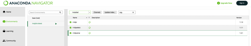

I'm using Anaconda Navigator to manage my scripting environments.  Within each environment I can add various Python or R libraries (including tidyverse).
The various packages can then be utilized within the Insights scripting console.  Would this be a possible solution for you?
