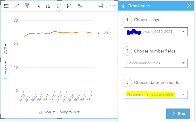

I have uploaded a CSV file in Insights which has a bunch of columns including date columns Date, year and month. I am able to create a line graph using year at x-axis. However, when I select the timeseries plot option, I get an error that no date/time field found.
How can I fix this?

SaadullahBaloch,
It seems that your date columns are being read as String field types and not Date/Time field types.  You can see more here.

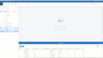

I recorded a demo (animated GIF below) showing how you can use the Data Table:
- Add a new field
- Calculate the data field as a time one, using your existing columns
- Create a Time Series table 🙂
The demo I use only has 10 values, so the resulting data table is really comical looking, but it works! 🙂
Please let me know if you run into any issues.
Also, here is the page explaining several of Insights' Date/Time Functions.
I scrolled down to Date Functions to find the Date(...) one. There are other options too, though.
I hope this helps! Thanks again for reaching out and thank you for using ArcGIS Insights!

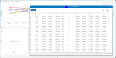

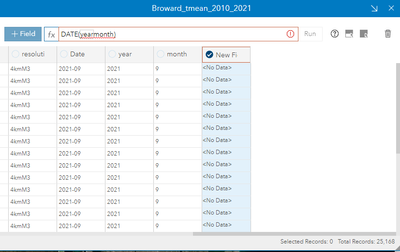

@Ian_Muehlenhaus thank you for your quick response and detailed guide. However, since my CSV does not have a day column, I am not able to create timeseries under the new field as show below.
How can I fix this?

Ian_Muehlenhaus
Hi @Ed_,
Okay, well... The insert a random number (I did "15", because the middle of the month just made sense to me) kind of works.
You might also consider inserting a random number between 1-28 (because of February short changes us 😉 to make the data look more organic.
I'm attaching a screen shot showing what I did and resulting data table.
Unfortunately, ArcGIS Insights appears to bin time series data into two-week stretches. The results in my sample case were passable. I'm not sure it will be for your data, though. Sorry if not. 😞

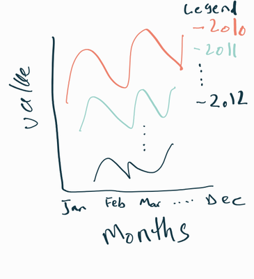

My data has monthly average data from 2010-21. So should I use random numbers from 1-12 or just 1?
The purpose of the timeseries plot is to create something like this:

I think what you're hoping to do may not work yet in Insights, as the timeline is aggregated weekly, not monthly.
Offhand, I don't know of a way to show average by month. 😞 I will definitely promote elevating this enhancement as soon as possible, though.
I'm attaching one last screenshot of how I put "15" into the Date function to try to get Insights to play nicely.
Sorry this is the best I can do. Again, though, others may be more insightful on this. This just represents my attempt.
