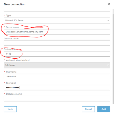

our JDBC connections use TCP/IP connection from ArcGIS Server to the database server name Specified, on the TCP/IP Port number, also specified when creating this connection:
Figure 1 Simple JDBC Connection Example

Let me know if this helps answer your question. Feel free to reach out for more information about other specific types of connections relevant to your working environment.
