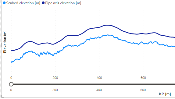

Hi,
Is it possible to have multiple fields within the Y axis within an Insights chart?
My data structure looks like the below, however contains up to 50,000 rows.
KP [m]Seabed elevation [m]Pipe elevation [m]
0-53-52.574
2-53.03-52.577
4-53.03-52.58
6-53.01-52.582
8.001-53-52.582
10.001-53-52.581
12.001-53-52.578
14.001-52.97-52.574
16.001-52.95-52.569
I want the KP column on the x axis and both the Seabed Elevation & Pipe elevation displayed on the Y axis.
It would like something like below (same data displayed in Power BI):
My testing within Insights thus far seems to indicate this is not possible.
Any responses would be appreciated.
Thanks
AndreasHall
A combo chart can do that if it is okay to treat KP as a string. Otherwise, I do not think it is possible without using Scripting (Python or R).
