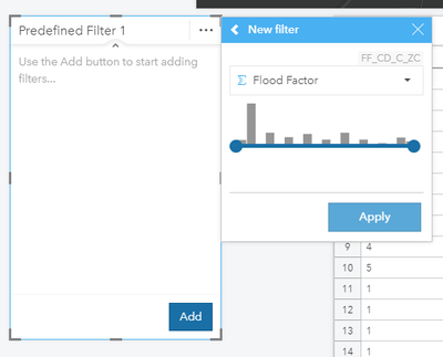

Hope all is well, so Insights does not support adding an integer column in a predefined filter as shown below.
Now a workaround for this is that I can change the datatype to string and then filter the values, and I can do a selection and show it on a map. But, I can't create other plots such as an histogram and any other exploratory statistics that does not support string data.
Is there a workaround to select an integer column in the filter, so that I can do other exploratory non-spatial analysis as well?

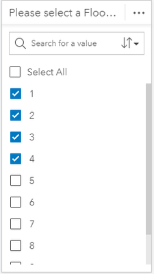

@Scott_Aulen hope all is well, can you please help me with the exact expression syntax to use? My column name is `floodfactor` and the values are from 1 to 10.
I did try `floodfactor` = 1 OR `floodfactor` = 2 .... OR `floodfactor` = 10 but this does not show the individual values to be filtered like this:

@Scott_Aulen or do I need to add them one by one like
Advance filter >  `floodfactor` = 1 > click add > rename `floordfactor` to `1`.
Advance filter >  `floodfactor` = 2 > click add > rename `floordfactor` to `2`. and so on...

FYI - my way of filtering for integer values is to use an advanced filter in the predefined filter
