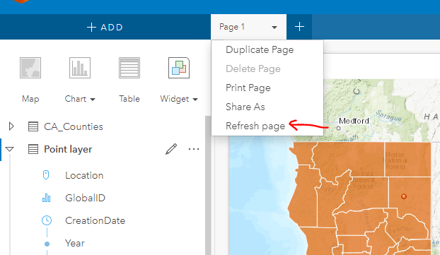

Hi Nathan, I tried a similar workflow and did not find this to be the case. I am editing a hosted point feature service in AGOL but edits do not show up in my Insights for ArcGIS workbook or shared page until I hit 'Refresh Page' in insights. I want this process to be automatic.
AnaSagastume
This is also happening to me. Did you do something different to make it work out in the end?
Thx
