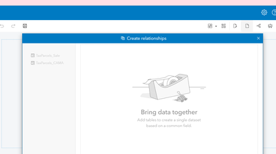

I leave a screenshot below. In this example there is a feature layer and two related tables created with survey123.
Thanks.

BalqisOpeyemiFamuyon
I am having the same problem. I can't seem to make a connection between my datasets even though they are from the same source. I have a screenshot below
