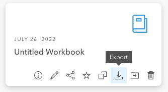

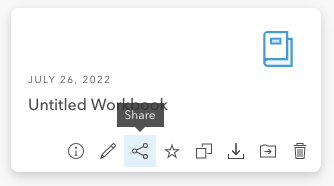

Scott_Aulen
Sure thing. There are two ways to get a workbook from Desktop to AGO.
1. You can share the workbook from the workbook page
2. You can export the workbook to your machine and then upload to AGO.
Do both options fail for you? What is the size of the workbook?

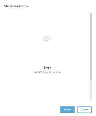

Hi Scott,
The first method fails as shown in the screenshot. I'll try the second method and report back. I'll share the workbook size once it completes saving. BTW the Insights Desktop app would really benefit from a workbook save/upload progress bar in percentage.
