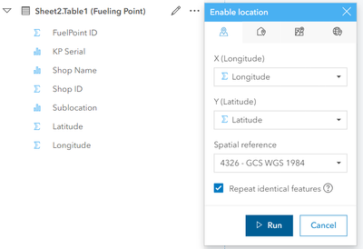

  1. Enable Location by LAT & LONG on Fuel Point ID (Sheet2.Table1 in give n dataset)\

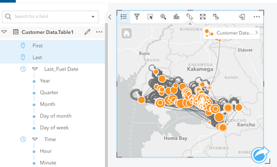

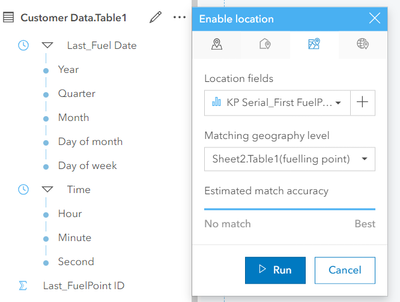

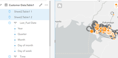

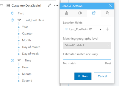

  2. On Customer Data.Table1 Enable location -->? Geography twice usingFirst and las fuel Point IDAkshayHarshe_2-1709766938009.pngAkshayHarshe_2-1709766938009.png

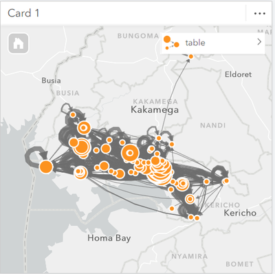

  4. Use both the Geographies to create a Link map
I am hoping this is what you need. If not, I recommend you prepare Lat/Long fields for First and Last Fueling points instead of IDs in the Customer dataset, then enable location XY on both.

In my situation if I use the same method as above am unable to proceed  beyond enabling location on customer data.
1. Enable Location by LAT & LONG on Fuel Point ID (Sheet2.Table1 in give n dataset) :This step works fine.

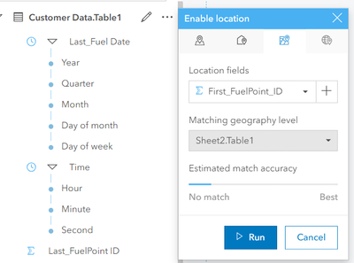

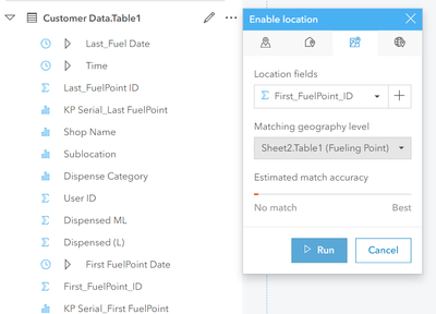

2. On Customer Data.Table1 Enable location -->? Geography twice using First and Last fuel Point ID. As you can see below under "estimated match accuracy" there's no match hence I cannot proceed. Am using the same dataset I shared with you. This happens both online and on desktop application
 Not sure whats wrong then

In this case, you do not want to check the "Repeat Identical Features" button in step one. (Enable Location by LAT & LONG on Fuel Point ID (Sheet2.Table1 in give n dataset))

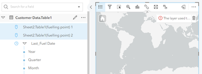

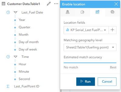

What works is when I use "KP Serial_LastFuelPoint and KP Serial_FirstFuelPoint. Though it cannot map

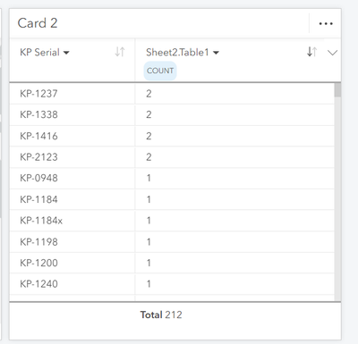

AkshayHarshe
@BarbaraSj This is expected since the KP Serial Column within "Sheet 2.Table1" you used in the enable location is not unique.
After using this column to enable location on your Customer Dataset it creates a many-to-many join that is not queryable since more than one record with the same name has been used.

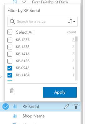

Use the dataset filter and remove these records from Sheet2.Table1 to resolve the issue.
Taking a closer look at the record same KP-# represents a different location, so it could be a data collection issue that can be resolved by modifying the source data.
Thanks,
Akshay Harshe
BarbaraSj
Hi Akshay
The above solution actually works when I remove the duplicates on KP serial. Thanks for the assist. Ill try to find out why using Fuel Point ID doesn't work/ there's no match when enabling by geography. As your example worked perfect
