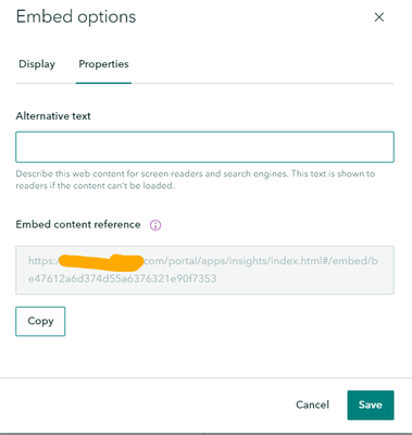

Had difficulties getting my insights table embedded in Storymap to display. Instead, the embed shows the insights home page, as shown in the attached photo. Was wondering why this was the case and I think I might have discovered why... The "embed content reference" in the storymap is to insights.com rather than to the specific insights page. Any idea how to fix this (and if this can be fixed on the insights end)?

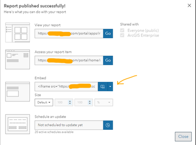

Looking at the embedded reference in your second image I see the URL to your home page which is why it is showing that.  You need to share the Insights page as a report and copy the <iframe> tag to the embed component in Storymaps

That is exactly what I did before. See below.
Every time I would copy the iframe into the embed link and enter in the embed, the embed content reference would revert to the insights home page after inserting. Any reason why this might be?
AkshayHarshe
@RylandLu  Looks like this is an issue in ArcGIS Online, I was trying it on my Enterprise and it was working. This issue is likely related to Storymaps because nothing has changed from our side. I will notify both of our devs and investigate.
