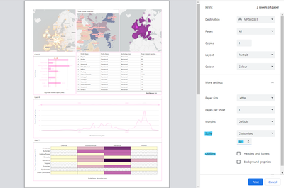

There is a workaround. You might need to fiddle around a little bit and design your page in such a way that your users can use the print option of the browser. You can do the following either in the page view or the Report Designer:
  1. Organize your report outside of the report designer keeping the card dimensions in the multiples of standard card width and height.
  2. Determine your printing size, In my case, I am using Letter paper size.
  3. Letter size in portrait mode You can fit 2.5 W x  3.5 H Insights standard-size cards when you print using the browser print option. OR 3 W x 4 H Standard cards if you reduce the scaling to 60%. See the example attached.
  4. Be mindful that at reduced scaling of the titles and axes labels will be smaller.
  5. You can choose to increase the font size of the cards.
Couple limitations:
  1. The Page background will always be white (Unless you create a text and media card with a colour or an image and put it in the back)
  2. 60% scaling can be smaller and you will need to educate the user to print at that scaling and options (see screenshots).
  3. This should print the current view e.g. if you filter something it will print the filtered output. Although the downside is if the user has clicked something then it will be selected in the print. (Meaning you need to use predefined filter for this to work)
