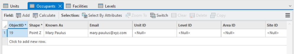

After doing the tutorial, I'm trying to use the Update Occupant Features tool with a csv file containing only two lines for two occupants on a units feature layer. I checked that both values in the UNIT_ID field are an exact match with the units features as well as for the USE_TYPE, OFFICE_NAME, FACILTY_NAME, LEVEL_NAME, LEVEL_NUMBER and VERTICAL_ORDER fields. Yet, when I run the tool, two lines are added in the occupant features as expected, but nothing shows up on the map and all of the fields are empty. I get this warning: 2 occupant assignment(s) could not be processed.
Is there something that can cause the match between UNIT_ID values to fail?

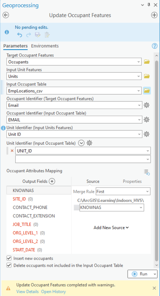

Thanks for the response, here is a screenshot of my csv file and the geoprocessing I'm running:

Everything looks good to me. A few things I would look at/try:
  • Verify that the UNIT_ID in the CSV matches exactly to the UNIT_ID in the Units feature class (I'm guessing you already did this)
  • Make sure the version you are working in is reconciled against default and that you are viewing the latest version (this has gotten me before where I updated some data and I thought it wasn't working, but I forgot to refresh my version to see the changes.)
  • I would try running it without the record that contains the accent in the unit id for Jim Baird. It's possible the special character might be an issue (doubtful, but possible).

Hi @SamuelMonat, are you still experiencing issues with this workflow? If so, could you send a screenshot of your Units layer attribute table to take a look at the UNIT_IDs that match the ones in the spreadsheet?
Regarding your question "Do you know if the other fields are used as well in the matching process?" -- No, the tool just looks at the inputs for the following parameters: Unit Identifier (input unit features) and Unit Identifier (input occupants table)
