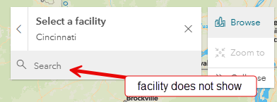

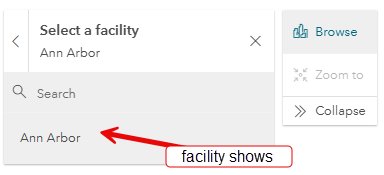

I have Indoor Viewer app deployed in Portal, 11.3.
I have a total of six buildings in my Indoors dataset.
When navigating using the Browse in the Indoor Viewer app, two of my locations do not list the Facility.
The Browse function works perfectly in ArcPro.
We're seeing it across all web browsers.
The Browse behaves the same as the Indoor Viewer in Map Viewer.
Why would the Facility load for some offices and not all?
Pro Browse:
Indoor Viewer Browse:
MelissaSalich
Solution - on the Site layer, Site ID field, there was an extra space at the end of my Site IDs.
I removed the extra space and now Indoor Viewer is working properly.
