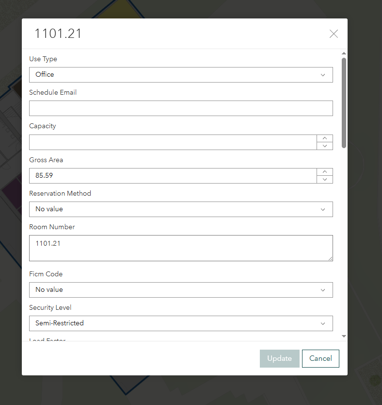

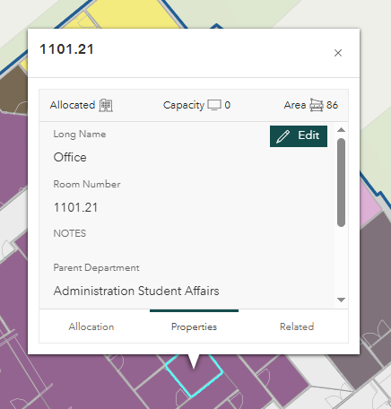

I am trying to figure out how to configure the form in the Space Planner application that pops up from the Edit button in the units pop up.
After a whole lot of messing around, I finally figured out how to configure the pop up but I cannot figure out how to edit which fields appear in the Edit form pop up. We need to restrict this so our users do not accidently edit certain data, but we would like them to be able to change room names, parent departments and make notes (not comments), but other things such as room numbers, gross area, and restriction level should not be changed by our users.
Is there a way to do this? I have tried creating a form in the map used by the Space Planner app and in a map with the plan's WFL, but it does not carry over. It does not seem that I can create a form just for the WFL, it needs to be within a map. There are no form settings within the Space Planner application settings that I can find either.

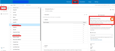

@MollyE I figured it out! Open up the item page for the hosted feature layer that has your editable Indoors layers. Go to the Data tab, then the Fields menu on the left. Open up each field that you want to make un-editable in the Space Planner app and uncheck the 'Allow Attribute Editing' option on the far right.
Now when users create a new Plan in the Space Planner app, those fields will no longer appear in the editing pop-up. Any previously created Plans will probably need to be deleted and remade for the changes to apply.

AaronKoelker
-Aaron

Oh wow, awesome! I just tried that and it worked. Thank you!
I didn't even have to delete the previously created plan, I just did the same for the feature layer that was created when creating that plan.
AaronKoelker
I'll add that one limitation I found with this is that if you overwrite the hosted feature layer then those "Allow Attribute Editing" options all get reset back to the default. But if you set those fields to "Read Only" in ArcGIS Pro (right-click the layer in your Map and go to Data Design > Fields) before publishing and it will carry over to the service. So far I haven't noticed any impact on functionality and have been able to create and merge plans.
