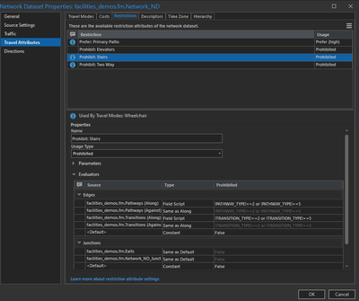

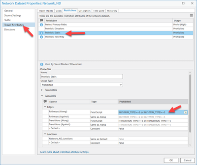

The Network Dataset is set up to avoid pathways and transitions features that are set as Type = Stairs / Curb or Escalator if the travel mode is set to Wheelchair. You can always inspect these properties in ArcGIS Pro by right-clicking the Network_ND dataset in the Network dataset.

Hi @HaleyBrueckman1, Is the TRANSITION_TYPE for your outdoor stair transition features set to Stairs / Curb? If not, changing this attribute and rebuilding the network should cause accessible routes to avoid these stairs.

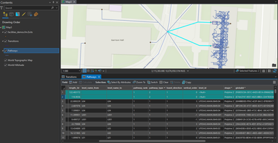

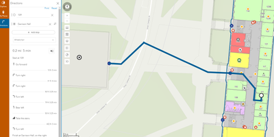

Hi, I went in and updated the pathways to be 'Stairs / Curbs'  and republished the Routes dataset but it doesn't seem to have fixed the problem. I checked all the settings and they seem correct, but it is still routing the wheel chair routes down stairs. See the screens shots for more details.

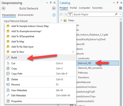

Hey @HaleyBrueckman1, After updating the attribute did you rebuild the network before republishing route layers?
To rebuild the network you can right-click the Network_ND dataset in the Network dataset and click Build. That will open the gp tool that you can run to rebuild it.

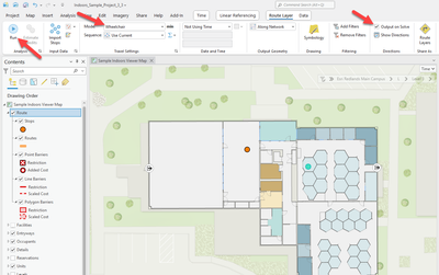

You can always verify that the route is working as expected by generating directions in Pro prior to publishing your analysis layers. To do this, add a routing analysis layer to the map, create two stops that you want to test the route between, choose Wheelchair as the walking mode and output directions on solve, then click Run.
