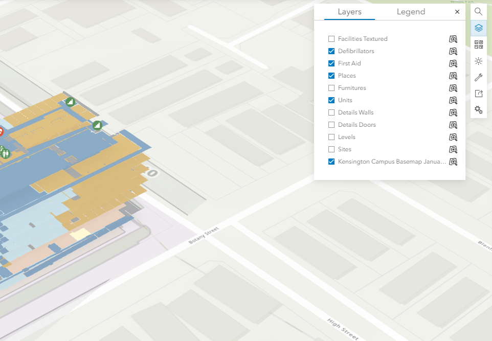

Hi Community,
I have successfully configured floor-aware map and scene in ArcGIS Pro and published them to AGOL. I can see the floor-selector tool with my published web map in the Map Viewer, but I cannot see any floor-selector tool in the Scene Viewer. Hence, there is no way for me to switch on/off floor plans and features in Scene Viewer. Am I missing something or there is no floor-selector in Scene Viewer?
(I created an Experience Builder App and used the floor-selector widget to achieve what I want, but wondering if I could directly turn on/off floors in a Scene Viewer?)
GauravJobanputra
@anbinh Floor filter is not yet available in Scene Viewer. You can use Experience Builder or Indoor Viewer to be able to switch floors in your 3D scene.

Thanks Gaurav,
Looking forward to seeing Floor Selector tool be implemented in Scene Viewer in the future.
