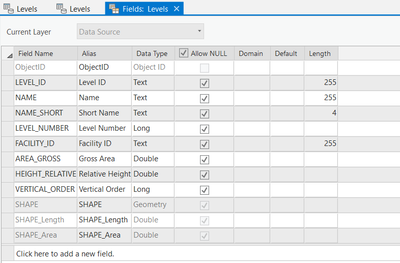

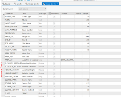

We had the same error message. I believe that the schema generated in the create indoors database and the schema needed to create an indoor network are slightly different. After running through the ESRI indoors training and downloading the sample data I noticed that we needed several additional relative elevation/absolute elevation fields that were not automatically generated using the create indoors database tool. After adding those fields the error message disappeared. Here is what is generated when running the create indoors database tool (using Pro 2.9.3 and enterprise 10.9.2).
Levels.
Levels in the ESRI sample data from ESRI
Anyways adding those fields seemed to get it to work. May or may not be relevant.
