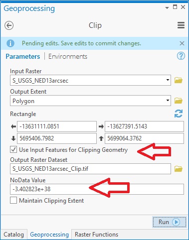

CodyBenkelman
If you define your polygon and then Run the “clip” tool, be sure to turn on checkbox to clip to geometry, and define a NoData value for pixels outside the polygon, you'll clip out a new image containing pixels only within the polygon:
Clip raster screenshot
If you do not wish to save your clipped file to disk, you can also use the CLIP raster function to create a temporary layer.

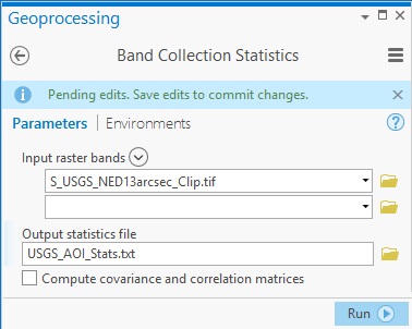

Then run "Band Collection Statistics" to calculate mean, standard deviation, more:
(note this requires the Spatial Analyst extension)
calculate statistics
Your statistics should not be counting the NoData pixels - verify that in your statistics table.  If you have a multiband file, you'll get statistics for each band

DanPatterson_Retired
MVP Emeritus
and from that you should be able to construct your desired t-test manually
