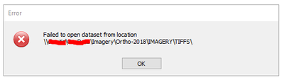

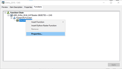

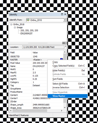

Still thinking about this one and I still think it is a path or permissions issue.  Does this occur if you just open the mosaic and not the image service?
Try the following:
1) Use the Identify tool, set the "Identify from:" to the imagery and click on the checkerboard.
2) In the dialog select the image, right click on the raster and select "View Raster"
Does it display on the Preview tab?
Go to the Functions Tab, right click on the image and select Properties... You may get an Error message.
Check the path and permissions for the error location.
If you do not get an error review the properties data.  If you are able post the data.
ar_tw
by
This seems to be the most up to date and complete thread about the checkerboard issue, so adding details about our case.
We were try to serve up ECWs which are not supported by Image Server.
Overviews were displaying correctly, as they get generated as TIFs, but zooming in to view the original raster results in the checkerboard effect. ArcGIS Server log simply had entries saying 'missing raster'. With no indication the ECW format was the problem.
