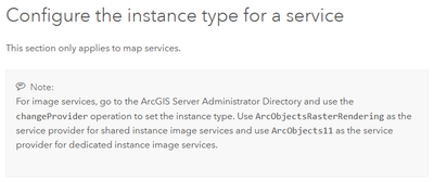

Looking at the documentation - https://doc.esri.com/en/arcgis-enterprise/latest/administer/configure-service-instance-settings.html...
It appears that the way to set shared or dedicated for Image Services is via the Server Admin rather than Server Manager
