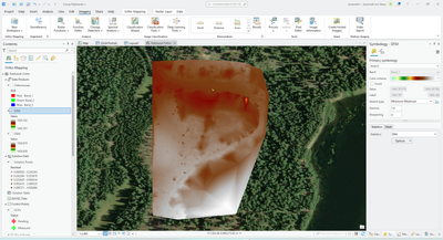

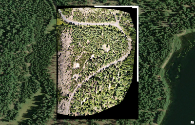

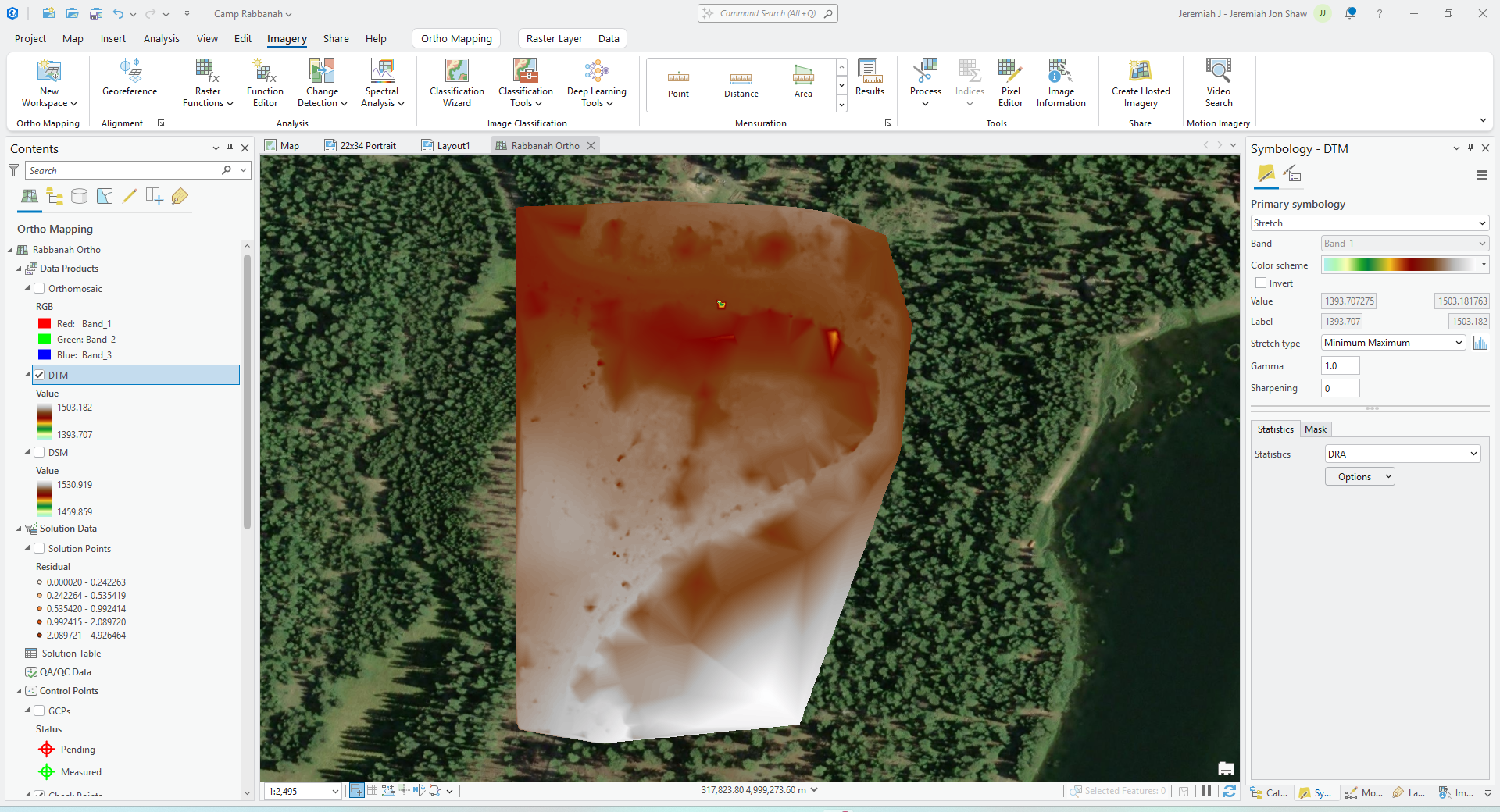

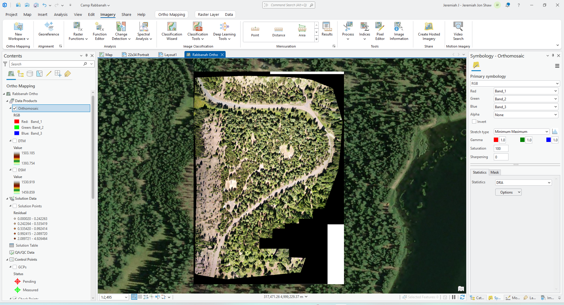

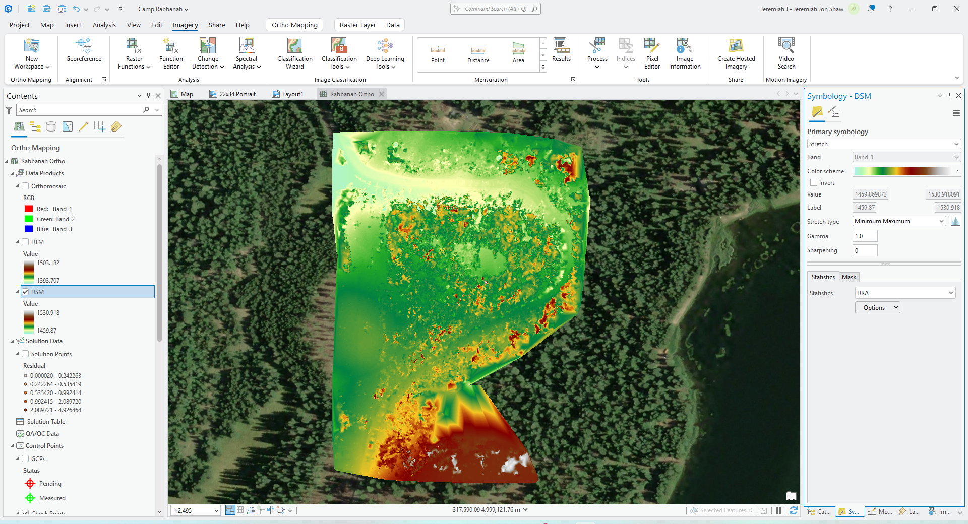

ArcGIS Pro 3.7 Ortho mapping Wizard - I ran my drone data to day to create an Orthomosaic, DTM, and DSM. when they were complete some of the imagery was blacked out (on the higher elevation section) causing a hole in my three layers. I have run three other imagery sets through this same process and did not have these issues, What am I missing?
during the block adjustment Process the log stated "41 unsolved images removed" how do I get these to be "solved" any advice will be helpful.

Hi Jerimiah,

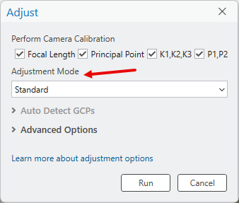

Good day. The unsolved images in the SE are a result of the dense vegetation causing image correlation challenges. What was the Adjustment Mode chosen in the Adjust UI?
If Standard, please re-run the adjustment using "Challenging" setting and let me know if there are dropped images and the amount.

I reran the Data from the beginning it turned out better, more useable space.
