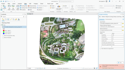

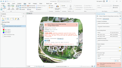

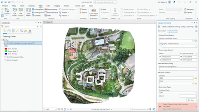

Hi may i ask something, why it shows this error, i already use proper aerial imagery and it still didnt work out as it shows error,can u guys guide to where i did it wrong or maybe i miss some step before use the deep learning

@arifsyakir I understand you're using CPU and maybe the Tree Detection pre-trained model from ArcGIS. The model is compute intensive, and a GPU with compute capability of 6.0 or higher is recommended.
https://doc.arcgis.com/en/pretrained-models/latest/imagery/introduction-to-tree-detection.htm
