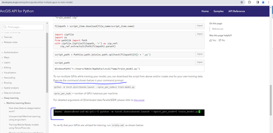

PriyankaTuteja
Dear @JadedEarth
The multi-gpu support for deep learning models listed here is available.
Please note: The multi-gpu training is supported with command line only. If you are trying to use ArcGIS Pro tools, it would not work.
JadedEarth
Can you show me the link to instructions on how to run multi-gpu from command line?  There should have been instructions/guide to do this from the outset.  When you advertised that multi-gpu is supported, nowhere did it state that it only works for command line and there are no links to instructions on how to go about it.
PriyankaTuteja
