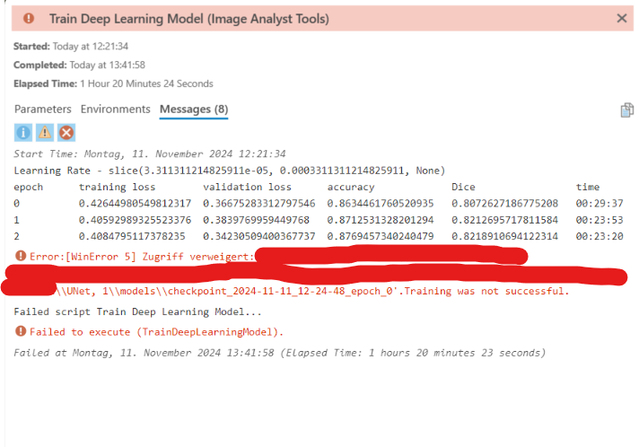

I tried to train a new deep learning model to classify pixels with forest/trees. However, I got this error message while training, saying that it cannot access a checkpoint:
I used the new ArcGIS Pro 3.4, but I tried on 3.3 aswell and it also did not work.
I trained some deep learning models before on 3.3 and it always worked. Since i didnt really change anything, I am a bit confused why it doesnt work anymore. Please let me know if you know something about this.
Thanks!
rachbauer
I did have it installed yes.
I "solved" the problem with the advanced technique of completly removing ArcGIS Pro and the framework and then installing it again hehe

did you install the deep learning frameworks for 3.4?
Esri/deep-learning-frameworks: Installation support for Deep Learning Frameworks for the ArcGIS Syst...
... sort of retired...
rachbauer
idanitorres18
I do... and the problem still,  do you have some other solutions?  I've try and anything works 😞
cweirpatrickco
I was getting this same error and tried setting the "Output Folder" param to a local directory (C:\Data\{output_folder}) rather than to a OneDrive directory (C:\Users\{username}\OneDrive\) and the tool ran with no errors... not sure why but just wanted to put it out there as a potential albeit likely temporary solution.
