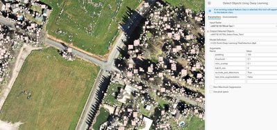

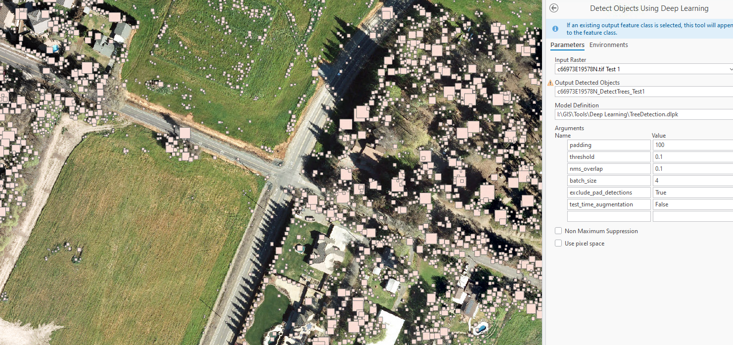

I'm trying out the Deep Learning Tree Detection model for the first time, using mostly the default settings (I did change the Cell Size to 0.25). But I'm very new to Image Analyst and imagery analysis in general, so I don't understand what most of these settings mean. It looks like the model was too "sensitive" when detecting trees, but also most of the boxes that are correct look too small - like they don't contain the entire tree.
How should I try adjusting the settings for my next test of the model?

@AndrewWallick maybe try with:
1. a few different thresholds (I see you're using 0.1; meaning if the model is 10% confidant it will return a result)
2. different cell sizes.
3. test_time_augmentation = True
