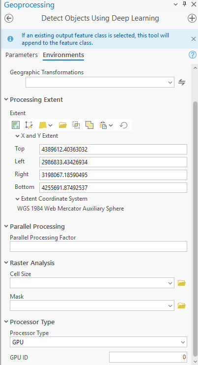

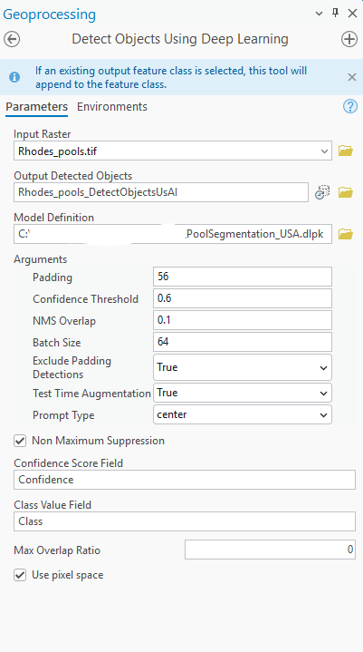

Once the raster is ready, I use the Detect Objects Using Deep Learning tool in ArcGIS Pro:
  • Input: the merged .tif raster (3-band, 8-bit), which in my case is ~2.3 GB.
  • Model: Pool Segmentation - USA with default parameters.
  • Processor type: GPU
  • Hardware: I run the model on a Virtual Machine with the following specs:
    64 GB RAM, Intel Xeon Gold 5220R CPU, and NVIDIA A10-12Q GPU.

  2. Why did you check the Use pixel space option? The Wayback imagery you used should already be geo-referenced, so it can be processed in Map Space without selecting pixel space. Could you confirm if you intentionally enabled this?
  3. You mentioned that the tool errors out in some cases when run on the full image extent. Could you share the error trace for those cases?
In addition, I’d like to suggest a few steps to improve results:
  • Use the recommended cell size for the pool segmentation model instead of the default value.
  • Lower the threshold to around 0.2 to segment pools with lower confidence, and then apply a definition query over the threshold field to filter the results.
  • To reduce processing time, providing the cell size should help.
  • If the error you encountered is a CUDA out-of-memory issue, try lowering the batch size from 64 to 4 or 8 — this should help resolve it.

For the settings of the model i changed:
-The cell size to 0.3 as it is recommended from the documentation
- The batch size to 4
- Deactivated the Use Pixel space
- Test time augmentation to false to reduce the time of each process
The output of the model i manually clean it by deleting the false positives.

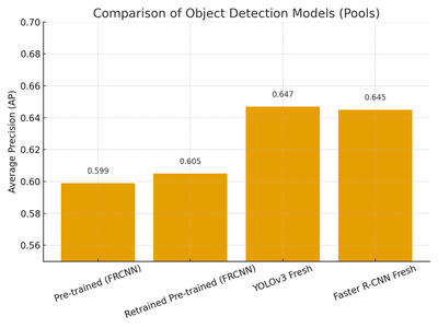

First of all i changed a bit my aspect of my research and adapted it in finding first the locations of the pools (and their total number also), so i changed the pre-trained model with the Pool Object detection - USA, which can be retrained, instead of segmentation.
Then used i exported as a training data the datasets which collected and cleaned by the first model, plus the 170 pools which i collected manually in a single feature layer.
With almost 1300 pools as training data ready, i begun the training sessions, where i retrained the pre-trained model Pool Object detection - USA, and 2 new fresh models, 1 in Faster RCNN and 1 in YOLOv3 architecture
Here are my results:
  • Pre-trained model Pool Object detection - USA: AP = 59%
  • Re-trained pre-trained model Pool Object detection - USA: AP = 60%
  • YOLOv3 fresh model: AP = 64,7%
  • Faster RCNN fresh model: AP=64,4%
Here are my conclusions:
Re-training the pre-trained model did not show any significant improvement. On the contrary, the fresh models showed much better results in terms of AP. In particular, the YOLO model, in addition to the better theoretical performance of the AP score compared to the other models, also had a faster learning rate in terms of learning speed.
Thank you for your kind support
