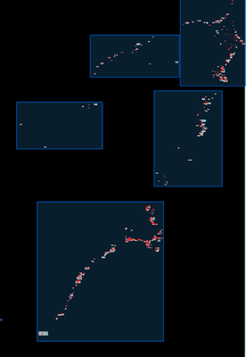

DimitrisPsarologos
I tried a different approach in the data management and running the model, including your suggestions
Let me, be more specific
First of all, i tried to merge all the tiffs with Mosaic data management tool, instead of Mosaic to New Raster and i created a new merged tiff.
Here is the new Raster information:
Columns: 177969
Rows: 260958
Number of Bands: 3
Cell Size X: 0.2985821416443992
Cell Size Y: 0.2985821416444002
Uncompressed Size: 129.76 GB
Format:TIFF
Source Type: Generic
Pixel Type: unsigned char
Pixel Depth: 8 Bit
NoData Value: 256, 256, 256
Colormap: absent
Pyramids levels: 8, resampling: Nearest Neighbor
Compression: LZW
Mensuration Capabilities: Basic
Secondly, i run the model in different smaller extents instead of the whole area, and then i merged the output layers
For the settings of the model i changed:
-The cell size to 0.3 as it is recommended from the documentation
- The batch size to 4
- Deactivated the Use Pixel space
- Test time augmentation to false to reduce the time of each process
The output of the model i manually clean it by deleting the false positives.
Also in during the process of cleaning i noticed many false negatives.
Specifically the model found 1300+ pools, which 1130 of them was actually pool. Also the estimated pool number in the case study area is approximately 2000.
For the next step I'm considering to utilize the false negatives to re-train the model for increasing it's accuracy from it's current 0.59
I really appreciate your opinion in the current process
Also i would like to ask, if there is any recommended number of samples to start with. What are you suggesting?
Thank you for your kind support

PriyankaTuteja
@DimitrisPsarologos  You could also try applying Non Maximum Suppression to reduce Overlapping detections.
DimitrisPsarologos
Hello and thank you for your advice
I also did a test in training models, which i want to share with you
First of all i changed a bit my aspect of my research and adapted it in finding first the locations of the pools (and their total number also), so i changed the pre-trained model with the Pool Object detection - USA, which can be retrained, instead of segmentation.
Then used i exported as a training data the datasets which collected and cleaned by the first model, plus the 170 pools which i collected manually in a single feature layer.
With almost 1300 pools as training data ready, i begun the training sessions, where i retrained the pre-trained model Pool Object detection - USA, and 2 new fresh models, 1 in Faster RCNN and 1 in YOLOv3 architecture
Here are my results:
  • Pre-trained model Pool Object detection - USA: AP = 59%
  • Re-trained pre-trained model Pool Object detection - USA: AP = 60%
  • YOLOv3 fresh model: AP = 64,7%
  • Faster RCNN fresh model: AP=64,4%
Here are my conclusions:
Re-training the pre-trained model did not show any significant improvement. On the contrary, the fresh models showed much better results in terms of AP. In particular, the YOLO model, in addition to the better theoretical performance of the AP score compared to the other models, also had a faster learning rate in terms of learning speed.
Dimitris
