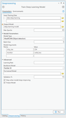

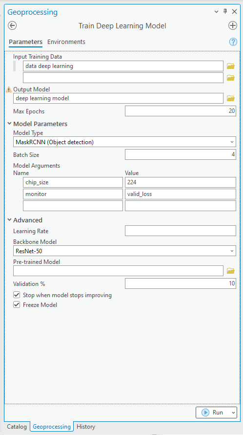

Here are the parameters I'm using to train the model on a sample area:
I have spent quite a lot of time, maybe you will have ideas how to fix it.

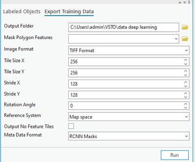

Yes, I'm using MaskRCNN model type and I exported all my data on RCNN masks.

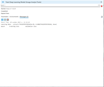

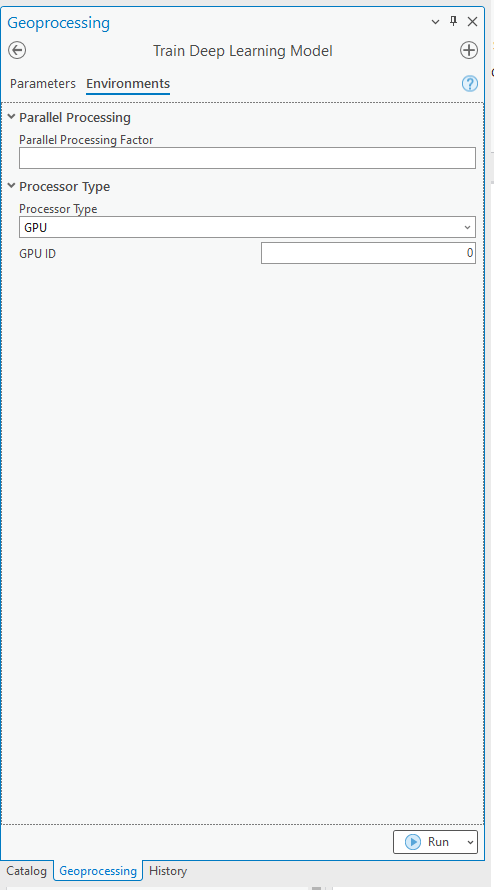

3) Yes, it was the name of a class, but I deleted it and now I have this:
I also solved problems with installing CUDA and so on to be sure that I would be able to run this training module:

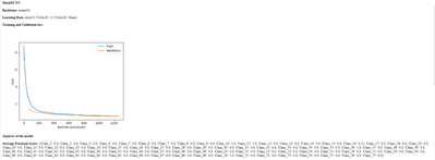

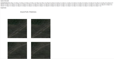

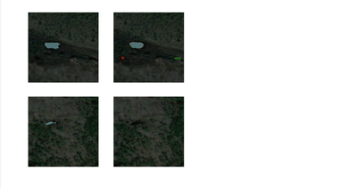

But, after 3 days, when it finally completed I have only 6 detected objects...
Maybe I don't have enough data to train the model (there were about 80 of them). I have an assumption that it is necessary to give about 1000 classes for training.
This is my model_metrics file:
