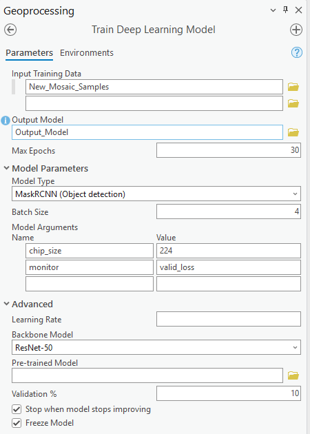

I'm trying to train my model and am getting the following error:
Start Time: Friday, August 19, 2022 8:59:06 AM

Here are the parameters I am using to train the model on a sample area:
I've been messing around with this for over a week and I'm stuck.  Any suggestions?

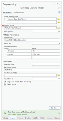

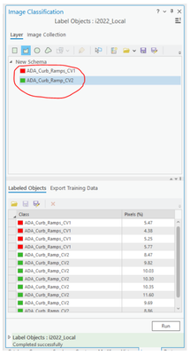

I finally figured this one out.  First of all, when using the MaskRCNN model for object detection, the class values for the input training data must start at 1 (I was using 0).  Secondly, you need to have at least two class values in order to train the deep learning model when using the MaskRCNN.  Here are the inputs I used that worked:
SteveCacioppo_0-1661521564562.pngSteveCacioppo_0-1661521564562.pngSteveCacioppo_1-1661521590642.pngSteveCacioppo_1-1661521590642.pngSteveCacioppo_2-1661521610238.pngSteveCacioppo_2-1661521610238.png

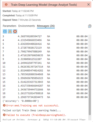

I read and followed your instructions but still no luck. Please, can you be more specific with the values recommendations for the values assigned to the samples?  Here attached are the messages I get when trying to train the model.

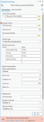

Hello, please I am having a similar issue here, I am using CPU and not GPU for this processing. I am aware the CPU can be used. I have reduced batch sizes from 16-12-8-4-2 yet unsuccessful. I will appreciate solutions achieved by anyone who has encountered this before. Thank you
PavanYadav
@Omoige23 this just appears wrong to me. If CPU or batch size was a problem, the tool would have returned error/messages. I see it trained up to 20 epochs and at the time of saving the model it failed. Is it possible for your to share the training data? If yes, please email me at pyadav AT esri DOT com.
The origional post was about
UnboundLocalError: local variable 'data_bunch' referenced before assignment
 I assume you don't see this error. Right?
