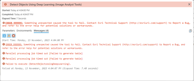

Hello everyone,
I am using a pretrained model for building detection on ArcGIS 3.0.0 Pro, when I set the processor type as CPU it works perfectly, but I want to use the GPU which is throwing these errors:
My GPU is Nvidia GeForce RTX 2070 Super. I checked if torch.cuda.is_available() returns true or not and it returned True.
Please help me in this.
Thank you in advance,
VinayViswambharan1
Hi @MayarAlzerki - The world imagery cannot be used for inferencing or programmatic access. It is violating the terms of use of the basemap (which is designed currently to be used only as a basemap).

PavanYadav
@MayarAlzerki
Can you share the name of the pre-trained model? Are you using a local raster (e.g tif , jpg) or using image service or webgis layer as an input raster?

MayarAlzerki
Hello Pavan,
Thank you for your response. The name of the pre-trained model is: Building Footprint Extraction - KSA.
Please find it through the following link: https://esrisaudi-ai.maps.arcgis.com/home/item.html?id=63785ee9860d4bd68cd82caccdcf1742
I'm using the world imagery service layer.

PavanYadav
@MayarAlzerkiI am sorry, I missed your last comment. When you use the World Imagery basemap layer, you need to define an extent (try a small one in the environment tab) and a cell size (something between 0.1 and 0.5). I agree, the error message was wrong. However, my understanding is that there are some licensing limitations on how you can use the World Imagery basemap as an input.

VinayViswambharan1

MayarAlzerki
Hello @VinayViswambharan1!
Apologiess, I think that I did not get your point. Do you mean that it's not allowed in GPU only? Because I can do detection using my CPU
PavanYadav
@MayarAlzerki it's a license limitation.
