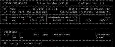

I'm trying to use GPU capabilities to train a deep learning model in arcgis pro using the 'train deep learning model' tool. I used the msi installation to install deep learning capabilities. It's working fine but is so slooooooow!
From other posts, I checked that Cuda is properly installed and that the python command  torch.cuda.is_available() returns True.

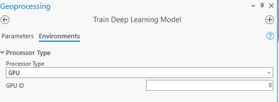

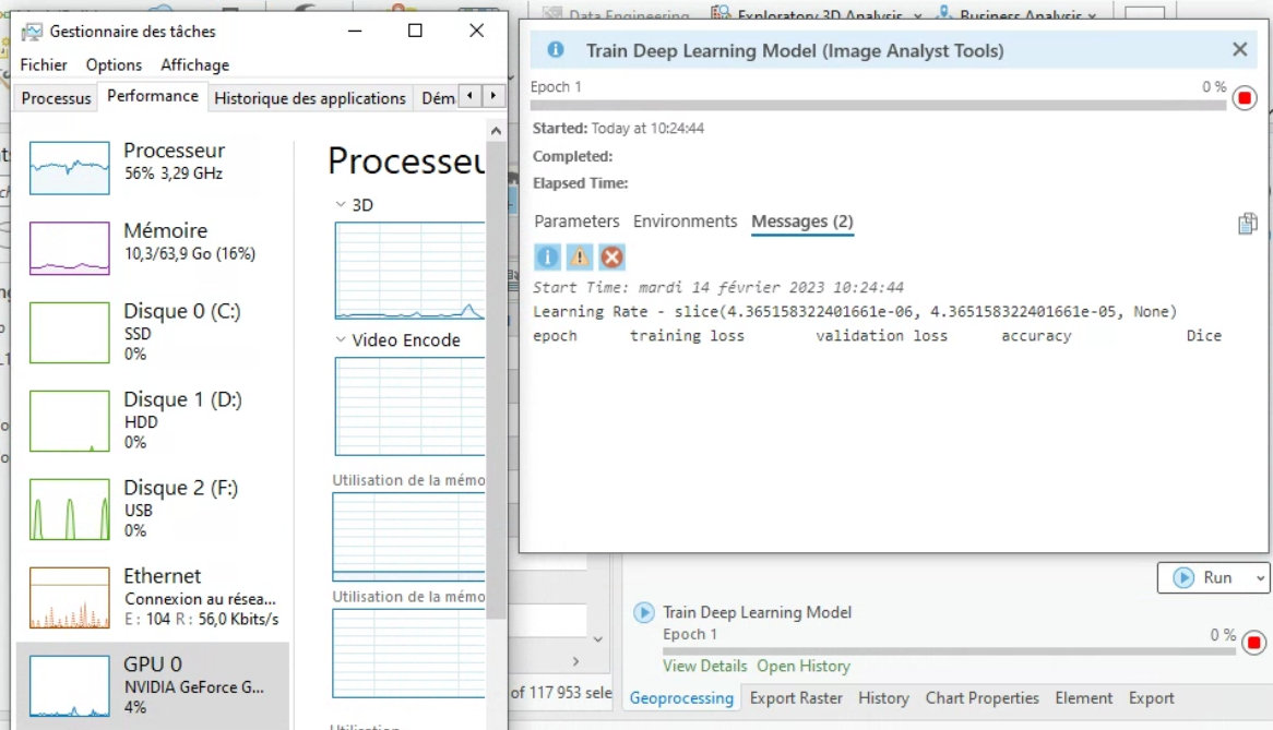

I've activated GPU in environment/processor type but looking at task manager, my GPU does not seem to work hard, neither the CPU's.

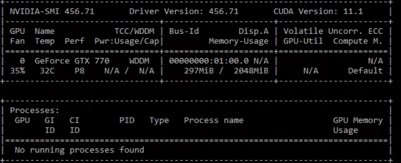

I also check with the nvidia-smi monitoring tool which confirms that no running processes are found:
I'm using a GeForce GTX 770. Maybe this model is not compatible? It's not brand new nvidia
Best regards
Adrien

@PavanYadav: yes I was setting environment just like that
I choose to buy a new GPU NVIDIA GeForce RTX 4090
That helped a lot 🙂

The recommended VRAM for running training and inferencing deep learning tools in ArcGIS Pro is 8GB. If you are only performing inferencing (detection or classification with a pretrained model), 4GB is the minimum required VRAM, but 8GB is recommended.
If you do not have the required 4–8GB VRAM, you can run the tools on the CPU, though the processing time will be longer.
@AdrienMichez  looks like geforce-gtx-770 is 2GB memory size. (https://www.techpowerup.com/gpu-specs/geforce-gtx-770.c1856)

@AdrienMichez I am curious if you were setting GPU in the Processor Type
You may also want to try to check:

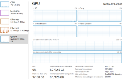

Hi @PavanYadav I have the same problem, I have an NVIDIA RTX 5000 graphics card, but when I perform object detection using deep learning, the card doesn't seem to be working properly. It does eventually complete the task, but it's incredibly slow.
AlejandraFigueroaMartnez_1-1721170852015.pngAlejandraFigueroaMartnez_2-1721170877214.png

Possible Reasons for GPU Underutilization:
  1. Small Batch Size: If the batch size is too small for the available GPU vRAM, the GPU may not be fully utilized. Try increasing the batch size to see if this improves performance.
  2. CPU-GPU Synchronization: The GPU might be waiting for the CPU to send data, leading to fluctuating GPU usage. Monitor CPU and GPU usage to identify any synchronization issues.
  3. Software Bug: as of today, we are not aware of any bugs related to GPU for this tool.
  4. Small Input Rasters: If the input rasters are very small (e.g., 1024x1024), GPU/CPU will give you about the same performance.
Additional Tests for GPU Verification:
  1. CPU vs. GPU Performance Comparison: A significant difference in processing time (3-4x to 20x) between CPU and GPU should be observed for large enough input rasters. Compare the processing times to determine if the GPU is working as expected.
  2. Large Batch Size Test: Setting a very large batch size (e.g., 1024) should result in a "CUDA out of memory" error if the GPU is functioning correctly. If you see a "CPU out of memory" error, try a smaller batch size like 512.

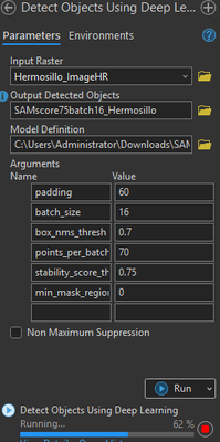

@PavanYadav
I’m using ArcGIS Notebooks in ArcGIS Online with GPU support to train a deep learning model (MaskRCNN) and publish the package (.dlpk). The training and publishing work well, but object detection with DetectObjectsUsingDeepLearning in ArcPy takes about 15 hours, even with GPU.
Questions:
  1. Web Applications: Is it possible to use the deep learning package in web applications for real-time object detection?
  2. Optimization: How can I reduce the detection time? Is it normal for it to take this long even with GPU?
  3. Recommended Workflow: What is the most efficient workflow for object detection with ArcGIS Online?
Thank you for your assistance.
