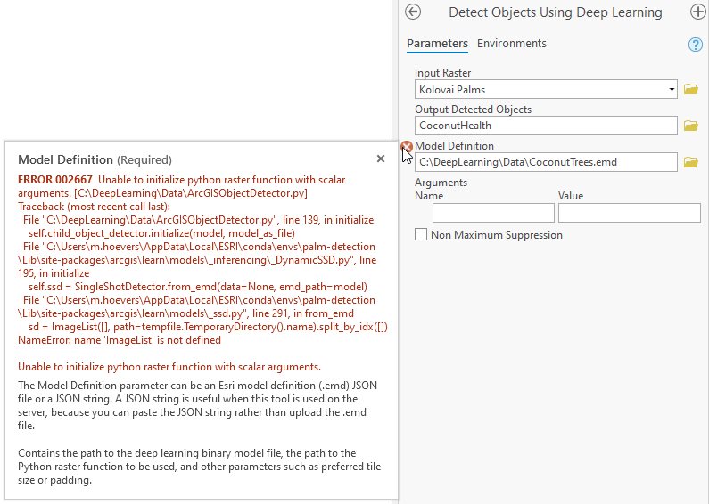

I'm following the lesson "Use Deep Learning to Assess Palm Tree Health". I've had some issues trying to train the model and decided to skip ahead to reviewing the model. I'm stuck on the step "Palm tree detection." In this step I'm trying to run the Detect Objects Using Deep Learning tool, using the .emd file provided in the lesson. I get the following error:

yea, I did all that... still getting this:

Even though I managed to train the model myself ( with solid help from our ML engineers ), in order to just get through the tutorial, I am trying to load the emd file that came with the downloaded tutorial data ( C:\DeepLearning\Data ), but I am still getting the above mentioned image.
Here is what I am doing:
- start ArcPro 2.5 and the CoconutHealth project
- open the "Detect Objects Using Deep Learing" tool
- Input Raster "Kolovai Palms"
- Output Detected Objects "PalmTrees"
- Model Definition "CoconutTrees.emd" (from C:\DeepLearning\Data)
and this error pops up:
I did find out that the machine I am using has a NVIDIA Quadro M4000 GPU.

got it to work.  after editing the (1)  _ssd.py and (2) _data.py files.
These are located here:
...\C\Program Files\ArcGIS\Pro\bin\Python\envs\palm-detection2\Lib\site-packages\arcgis\learn\models\_ssd.py
...\C\Program Files\ArcGIS\Pro\bin\Python\envs\palm-detection2\Lib\site-packages\arcgis\learn\_data.py
We added "arcgis.learn" before each ".model" :
Now I can access the next steps such as padding (56???)-
