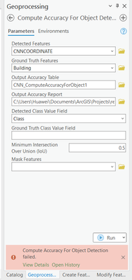

compute accuracy for object detection is having error9999

Hi,can someone help me why my compute accuracy for object detection is having error9999 can someone list all possible mistake that are common or maybe ive make some mistake

Hi @arifsyakir1
Can you please try the following two?
1. Spatial Reference of both Ground Truths and Detected Features is the same.
2. Use a Ground Truth Class Field.
if either still don't help, please reach out to Esri Technical Support: https://support.esri.com/en-us/overview
