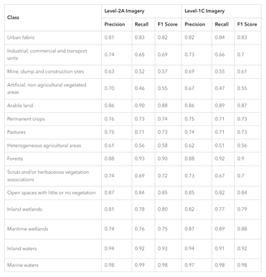

Land Cover Classification (Sentinel-2) pretrained model is trained with 16 lulc classes but from the error it seems you are trying to train the model with data having only 2 classes. For finetuning any pretrained model it is expected to train the model on same number of classes.
These are the classes on which the model is trained:
The model is trained on Corine LULC data
