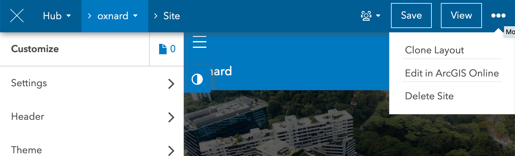

Unfortunately, since all Hub content is tied to potentially multiple items and groups in ArcGIS Online, there are many potential causes for site corruption. We definitely hear your concern about site corruption and are working to reduce the issue, but in the meantime cloning your site (or "backing up" as Nick puts it) is the most straightforward way to proceed. You can clone a site by clicking the overflow menu in the upper right of the site editor and clicking "Clone Layout":
This will make a fresh copy of your site that you can then rename to match your old site's domain.
Again, I'm sorry you're having issues with site saving and we're doing what we can to reduce occurrences such as these.
