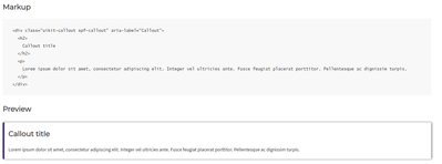

One significant issue that I have encountered, however, is that my workplace has website style guidelines in place, which are packaged up into a product called Single Public Face (SPF) 2.0. There are example code snippets provided (e.g. link) to produce different features; the screenshot below is one example:

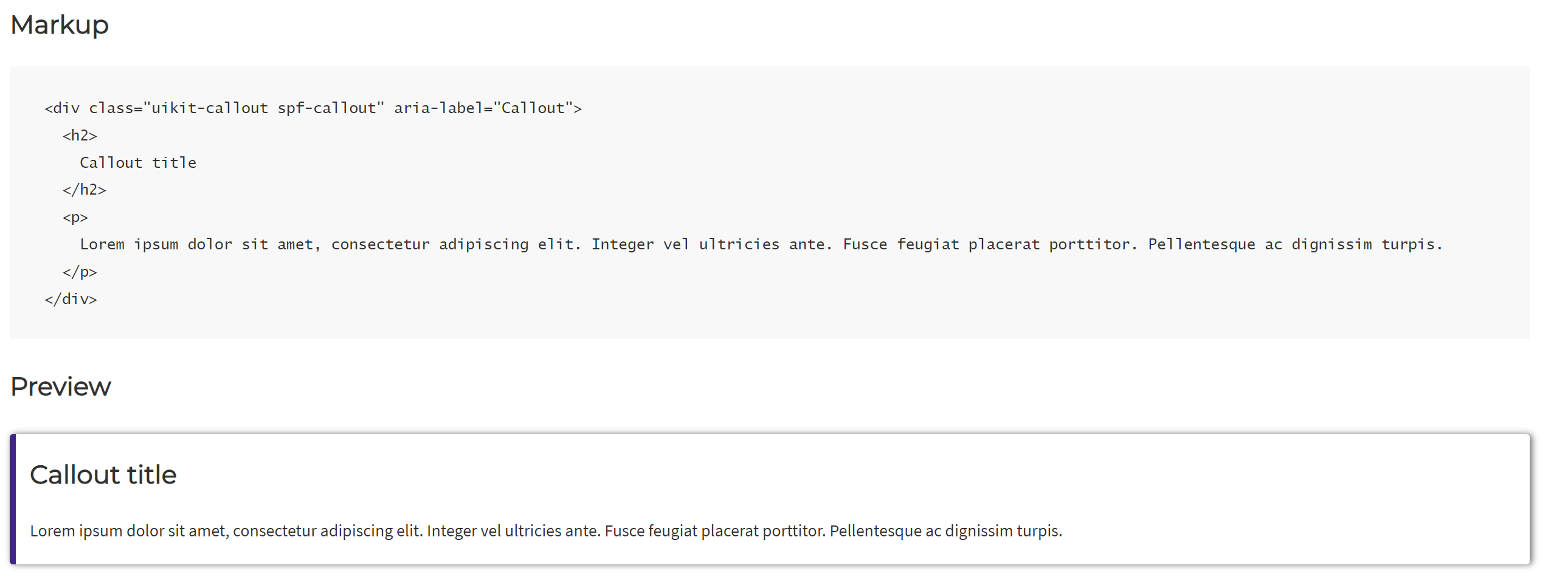

However, when I used this code block in ArcGIS Hub, this is what I got (i.e. without the fancy border):

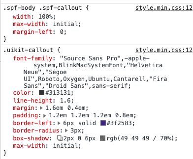

It looks like your component probably does require some CSS to render properly and that the package you're referencing is more like a standalone framework. Our framework for Hub is Bootstrap 3 and Calcite. In order to duplicate the styling attached to .uikit-callout .spf-callout, you'd want to inspect it on the Public Face site and then apply the associated attributes via embedded stylesheet on Hub with a Text Card. Embedded styles go between <style></style> tags.
Looking at the Public Face source code for that callout, these are the styles you'd want to insert between style tags to get a comparably branded callout. (One thing to note, Hub applies font family by whatever is set in Theme > Base Font / Heading Font, so if you're trying to target fonts that do not naturally occur on the end user's laptop, you'll want to set the URL over there.)

ChrisMalam
Thank you for this explanation, Klara.
While I had a sneaking suspicion that the public face was a standalone framework that would not integrate with ArcGIS Hub, this look-alike callout box is brilliant, thank you! Also really good to know about setting the font style under Themes, have been able to select our preferred fonts.
