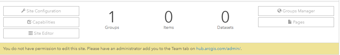

I tried to go to TEAM tab and add team members, but it does not allow me:
The only picture I get is this, saying that I would need an administrator to add me to the Team Tab even though I am the admin and I am trying to add other people in the Team Hub:
This is the same picture I get when I click the "Sites" tab as well.

This can occur if you delete the underlying groups that the Hub application uses to function (Hub Administration Group). The new group can be created/restored but old sites will still be looking for the old group and this message will display. To fix it, you need to update a property of the Site in question to match the current Hub Administration Group for your organization.
You can find the current Hub Administration Group ID in your portal self call underneath portalProperties. You can update the Site by using AGO Assistant. The property that caches the group is `item.properties.collaborationGroupId`
Technical support can assist with this process if you open a ticket. We are working on longer term solves to the search API to alleviate the need to cache the group's ID in the Site's item.
