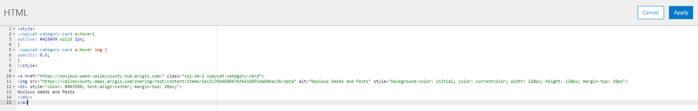

KaraUtter
Hi @KlaraSchmitt !
I had seen a few of your examples of html/css in hub while I was trying to figure this out. Thank you for responding!
I tried what you said above and still didn't get the hover effect. Should my HTML builder look like this?
KlaraSchmitt
Hi Kara,
My apologies, there was an error in my code. You can see that I put the .copycat-category-card class on the actual link element, but then in the style tags, I told you .copycat-category-card a to target it and there's no way that would work because <a> would have to be a nested element of .copycat-category-card. It should have been a.copycat-category-card which means find the <a> that has the class of .copycat-category-card attached and then apply the hover as a pseudo class. I've updated the code snippets above.
KaraUtter
Yes! Thank you so much Klara! That was one of the finishing touches I needed before go-live for our Hub site.
