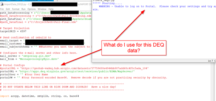

kapalczynski
It wont even auth and get me into their portal....
This is the Hub trying to get to:
https://geohub-vadeq.hub.arcgis.com/datasets/57759688e4944bb987add68c4f0c5ada_104
This is the URL set up in ArcGIS Pro
https://apps.deq.virginia.gov/arcgis/rest/services/public/EDMA/MapServer/
  1. what am I supposed to use for portalURL?
  2. Its open to the public therefor NO user name or password????
