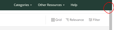

I've created a custom header for an Enterprise Site using the Calcite Bootstrap sample code. I've made some minor inline CSS changes, like floating the menu items to the right, but overall I am relying on the header to pick up CSS from the rest of the site (see below for full HTML).  This works well for the most part, but there are two issues:
  • For menu dropdowns, the header seems to be picking up the 'Body Link Color' set in the Theme settings, instead of using the 'Header Text Color'. Note that there is no option to set a header link color. This is causing usability issues because the header background is darker than the body background, making the links hard to read - see 'Categories' below:
I've tried applying some custom CSS classes (see below) in multiple places to address this, but haven't been successful.
.navbar a,
.navbar a:hover,
.navbar a:focus,
.navbar a:active { color: #F1F7ED; }
  • When opening apps from the site, the custom header blocks content at the top portion of the screen. In the example below, I've added blank space to the top of the app to account for the header, but you can see the issue where the scroll bar is cut off:

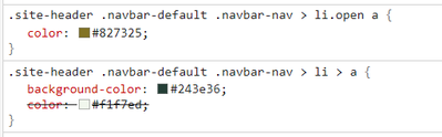

As for the link colors in the header, I tried the suggested selectors but didn't see any changes. Since this only happens when the dropdown menu is opened, I investigated with Chrome developer tools and found the following:
The CSS settings are being overwritten by li.open a. I did try adding li.open to the CSS selectors but that didn't work either. Any ideas what might be happening there?

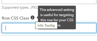

I've seen the "Row Settings > Appearance > Row CSS Class" and I get the concept from 10,000 feet but am not quite clear on how to put it into practice. I can't seem to find any examples of this through Google (if I use quotes in my search, I keep landing on this page). I get that I'm to reference a CSS class but I don't know what name to use or where to put my own custom class so I can create properties for it and then reference it.
In the likely event that others will land on this page with the same question, do you mind taking a minute to provide a simple snippet showing how to put Row CSS Class into practice? Or maybe just reference a helpful doc for us (again I'm using Enterprise Sites)?  Thank you.

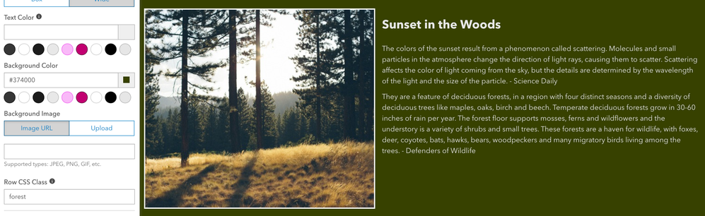

Here is a row in my site. It has an Image Card and a Text Card. I've given it a unique row class of forest

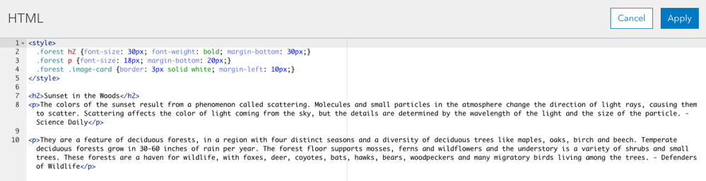

Now that I have a unique row class, I can open up a Text Card anywhere on the page and add CSS that utilizes that class to target the elements within the row.
To write out what I have in the code screenshot above, I have embedded styles that specify my row and then the elements within my row that I want to spruce up with additional CSS.
<style>
  .forest h2 {font-size: 30px; font-weight: bold; margin-bottom: 30px;}
  .forest p {font-size: 18px; margin-bottom: 20px;}
  .forest .image-card {border: 3px solid white; margin-left: 10px;}
</style>
If you were to inspect the code of the Image Card, you would see it has a class .image-card. That is an example of one of our component classes and one you don't want to straight up target without a unique row wrapping class.
